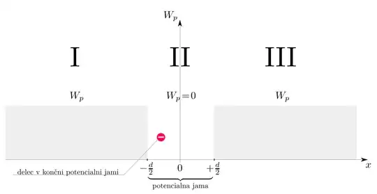

Lets say we have a finite square potential well like below: finite well
This well has a $\psi$ which we can combine with $\psi_I$, $\psi_{II}$ and $\psi_{III}$. I have been playing around and got expressions for them, but they are not the same for ODD and EVEN solutions but lets do this only for ODD ones.

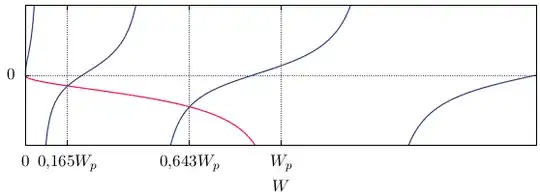

When i applied boundary conditions to these equations i got transcendental equation which is:
\begin{align} &\boxed{-\dfrac{\mathcal{L}}{\mathcal{K}} = \tan \left(\mathcal{L \dfrac{d}{2}}\right)} && \mathcal L \equiv \sqrt{\tfrac{2mW}{\hbar^2}} && \mathcal K \equiv \sqrt{\tfrac{2m(W_p-W)}{\hbar^2}} \\ &{\scriptsize\text{transcendental eq.} }\\ &\boxed{-\sqrt{\tfrac{1}{W_p/W-1}} = \tan\left(\tfrac{\sqrt{2mW}}{\hbar} \tfrac{d}{2} \right)}\\ &{\scriptsize\text{transcendental eq. - used to graph} } \end{align}
Transcendental equation can be solved graphically by separately plotting LHS and RHS and checking where crosssections are. $x$ coordinates of crossections represent possible energies $W$ in finite potential well.
So i can theoreticaly get values for possible energies $W$ and when i get these i can calculate $\mathcal L$ and $\mathcal K$. But i am still missing constant $A$.

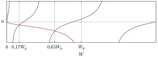

I first used constants above to again draw a graph of transcendental equation and i found 2 possible energies $W$ (i think those aren't quite accurate but should do). This looks like in any QM book (thanks to @Chris White):
Lets chose only one of the possible energies and try to plot $\psi_I$, $\psi_{II}$ and $\psi_{III}$. I choose energy which is equal to $0.17\, W_p$ and calculate constants $\mathcal K$ and $\mathcal L$:
\begin{align} \mathcal K &= 2.3325888\cdot 10^{10}\\ \mathcal L &= 1.5573994\cdot 10^{10}\\ \end{align}

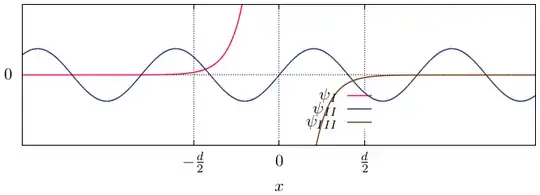

Now when the picture above looks like in a book i will try to use constants $\mathcal K$, $\mathcal L$ and $\boxed{A \!=\! 1}$ (like @Chris White sugested) to plot $\psi_I$, $\psi_{II}$ and $\psi_{III}$. Even now the boundary conditions at $-\tfrac{d}{2}$ and $\tfrac{d}{2}$ are not met:
EXTENDED QUESTION:
It looks like boundary conditions are not met. I did calculate my constants quite accurately, but i really can't read the energies (which are graphicall solutions to the first graph) very accurately. Does anyone have any suggestions on how to meet the boundary conditions?

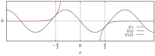

I found the case myself. There was a mistake in a GNUPLOT script. The line:
g(x) = -( A*exp(-L*(d/2)) )/( sin(L*(d/2)) )*sin(L*x)
Should have $\mathcal K$ in place of the first $\mathcal L$. This was the first mistake but after i fixed it my graphs still were sloppy, so i redid all the readings for energies from a graphicall solutions to the transcendental equations and recalculated $\mathcal K$ and $\mathcal L$. As it turns out my graphs now came out perfectly!
Here are the images:
Thank you all for the help. Reward goes to @Chris White.
