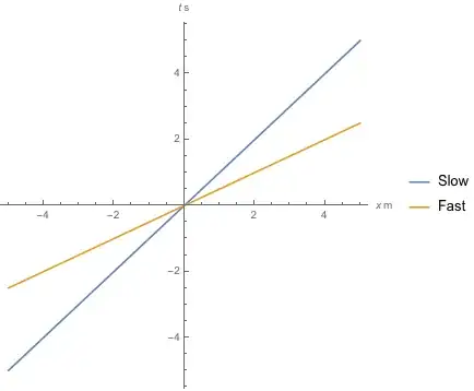

Get rid of the planet in your scenario. Just have two objects at the same place and same time in (1+1D) flat spacetime. Let's build our reference frame so that they both start at the origin $(t,x)=(0,0)$, with one moving at $1\,\mathrm{m}/\mathrm{s}$ in the $+x$ direction and one moving at $2\,\mathrm{m}/\mathrm{s}$ in the $+x$ direction. In spacetime, are these objects moving on the same path? I think you might say yes, because both are following the spatial path $t = 0$, but the answer is emphatically no! The path of an object through spacetime is just that: the path through space and time. Our "slow" object follows the path $x=t\cdot1\,\mathrm{m}/\mathrm{s},$ and our fast one $x=t\cdot2\,\mathrm{m}/\mathrm{s}.$
time-space diagram of objects' paths through spacetime; they are lines both passing the origin, but with different slopes
What you're thinking of as the "path" is the "shadow" of the full spacetime paths onto the "spatial hyperplane" (in this case, on the x-axis; in your question that would be 3-dimensional "space"). But this is SR/GR: the whole point is that looking at just space is not enough. In any case, now that we've established that objects with different velocities already follow different paths through spacetime, even if spacetime is flat and even if they start at the same point. All that I really need to say is that a curved spacetime can allow this difference, which looks "temporal" right now, to bleed over and become "spatial".
Now, I'm not going to go all in on the GR, but for low-mass objects like Earth, most of the gravitational attraction comes from the curvature of time, not space. All objects naturally move towards the future, and the gravity of Earth means the futureward direction acquires an inward radial component near its surface (as compared to an observer in free-fall "far away"). Falling towards the Earth is as inevitable as moving through time... which is, as shown above, pretty "evitable" if you go fast enough. In the case of us evidently not falling through the floor, this is because the repulsion between our atoms and the Earth's constantly accelerates us at $1 g$ upwards, as long as we are mechanically connected to the surface.
Now, I said I wouldn't go full GR. Instead, I'll say this: even here, on the surface of the Earth, we can approximate spacetime as flat (so we're in SR land), and things appear to accelerate under gravity simply because we're in a non-inertial frame constantly accelerating upwards under the normal force of the ground. As an SR trick, we should use Rindler coordinates. Rindler coordinates in SR are the coordinates of a non-inertial frame of reference that has constant proper acceleration. Seen from an inertial frame, the Rindler coordinate axes are curved. Seen from the Rindler frame, the Cartesian axes of the inertial frame are curved. Assuming we're accelerating at $a=9.8\,\mathrm{m}/\mathrm{s}^2$ along the $+y$ direction and we let the origin be shared, the transformation from inertial $(t, x, y)$ coordinates to Rindler $(T, X, Y)$ coordinates is $$T=\frac{c}{a}\operatorname{arctanh}\left(\frac{tc}{y+\frac{c^2}{a}}\right),\quad X=x,\quad Y=\sqrt{\left(y+\frac{c^2}{a}\right)^2-c^2t^2}-\frac{c^2}{a}.$$ If we extend our above graph with a $y$-axis, which pokes into/out of your screen, then the $t$-axis is defined by $x=y=0.$ We can graph this in the $T-Y$ plane of our new coordinates:

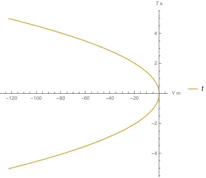

Graph of t-axis in Rindler coordinates, which looks like a parabola
(Note: this is almost but not quite (a few parts in [insert-big-power-of-10-here] off) a parabola). In the above graph, the $X$-/$x$-axis is going into/out of the screen. If you imagine taking our graph from above, aligning its $x$- and $y$-axes with the $X$- and $Y$-axes here, and then bending the $y$- and $t$-axes so they line up with the $Y$- and $T$-axes, then the worldlines of the two objects also bend to give the path as we see them from our reference frame attached to the "ground". Since the objects had no $y$-component to their motion, their worldlines are actually "on top of" the $t$-axis curve above, so the above plot also serves to show the (almost)-quadratic relationship between height and time elapsed for the objects as they fall under gravity. Note that their apparent acceleration and subsequent displacement in the $Y$-direction (which you might consider the "spatial" direction "height") comes purely from the bending of the time axis.

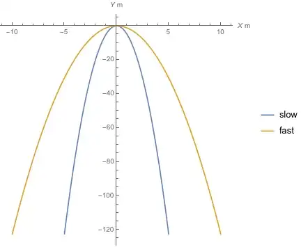

Now, if we rotate the superimposed graphs so the $X$- and $Y$-axes are visible but the $T$-axis disappears, we finally recover your spatial paths. While in the inertial frame, the spatial paths of the two objects coincided, the curvature of the Rindler coordinates has turned the temporal separation between them (due to their different velocities) into a spatial one. My demonstration is purely mathematical—the spacetime described by Rindler coordinates is still flat, even if the coordinates are curved—but I hope you can see that in GR, where spacetime really does curve, that curvature can "detect" the difference between objects moving at different velocities, because the objects simply are going in different spacetime directions.
(Almost)-parabolic "spatial" trajectories of the objects, in the X-Y plane

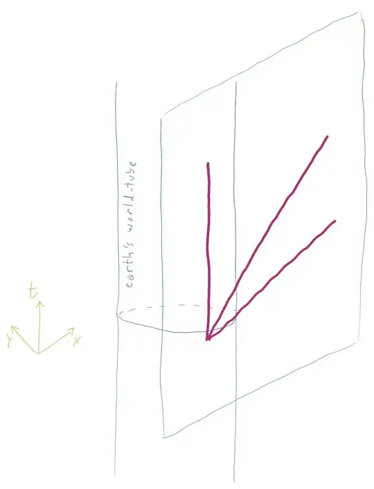

As others have explained, the main point is that curvature is in 4D, not just 3D. In fact, the main "warping" happens in the time direction.
I just want to help your imagination with two pictures.
Consider a 2D space (horizontal) + time (vertical) spacetime, and a reference frame with the Earth at rest, as in the first picture below. The Earth is a 2D disk; its world-tube (thin blue line) in this spacetime is a 3D cylinder.
Flat 2+1 spacetime
Take three projectiles starting a tangential motion above the Earth's surface (thick red lines). The first has zero initial velocity with respect to the Earth, so its worldline starts vertically. The second has a non-vanishing tangential velocity, so its worldline starts at some angle with a horizontal plane. The third has a higher initial tangential velocity than the third, so its worldline starts at a smaller angle with a horizontal plane (same space = horizontal span in less time = vertical span).
If this spacetime were flat, as in the picture above, the three worldlines would lie within a plane (green) parallel to the earth's worldtube. The first projectile would stay still, not falling, with a straight vertical worldline. The other two would also have straight worldlines continuing away from the earth's worldtube.
The energy-momentum-stress of the earth curves spacetime instead, as shown in the second picture below. The worldline of the projectile with initial zero velocity is bent toward the Earth's worldtube – thus acquiring a radial velocity and eventually touching the Earth's surface. The worldline of the second projectile is bent around the Earth's worldtube; this is seen as an orbital motion. The worldline of the third projectile is also bent toward the Earth's worldtube, but not as much as the second. It eventually continues far away from the Earth (and becomes "straighter", as the curvature diminishes); this is seen as an escape from the Earth's gravitation.
Curved 2+1 spacetime
So the spacetime curvature bends worldlines with different "inclinations" in different ways. Hence the dependence of velocity, which is how we see such inclination.

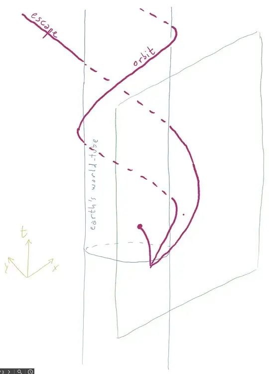

The fact that most of the curvature is in the time direction becomes clear if you take natural units for space distance and time lapse (1 s = 300000 km). The worldlines of ordinary projectiles are almost "vertical", and their bending only occurs over huge "vertical" distances in this example spacetime.
The moon, for example, has a velocity of roughly 1 km/s. In natural units this would be a worldline with an angle of 89.9998° from the horizontal plane. And the spiral of its worldline would form one coil only after a vertical distance of roughly $56\,000\,000$ times the diameter of the Earth's worldtube depicted here – you'd need roughly $56\,000\,000$ screens on top of each other to see one coil, if the picture here respected natural units.
An even simpler intuitive picture is obtained considering a ball thrown vertically, with different initial speeds. I invite you to draw a 1+1 spacetime picture of the worldlines of the ball with different initial velocities (they'll look like parabolae) – you'll see the effect of curvature, and its dependence on velocity, directly in front of you. Also check out how these parabolic worldlines would look like, using natural units.
(Please note that the pictures above only have an illustrative purpose, they aren't plots of solutions of 2+1 Einstein equations or anything of the kind; and sorry for the poor draughtsmanship!)
