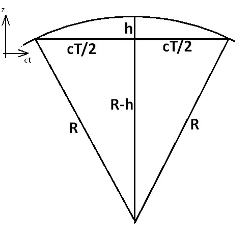

Our goal is to find the curvature radius $R$ in 4-dimensional space-time. We can draw the curved trajectory in space-time ($z$ versus $ct$).
Of course this drawing is not to scale. Because of the huge value of $cT$ the curved trajectory at the top would be much less curved, and the center of curvature would be much further down. But it is enough for analyzing the geometry.
Applying Pythagoras' theorem to the right triangle we get: $$\left(\frac{cT}{2}\right)^2+(R-h)^2=R^2$$ or $$\left(\frac{cT}{2}\right)^2+R^2-2Rh+h^2=R^2$$ The $R^2$ cancels out. We can neglect the small $h^2$ and resolve for $R$: $$R=\frac{(cT)^2}{8h} \tag{3}$$ The calculated values of this curvature radius $R$ are also shown in the table above. It turns out, the radius $R$ is huge (nearly one light year) and (may be as a surprise) completely independent of the trajectory. To understand how this comes about, we can insert $h$ and $T$ from (1) and (2) into (3). We find $$R=\frac{c^2}{g} \tag{4}$$ This relation makes evident: The curvature of the trajectory in 4-dimensional space-time depends only on gravity $g$ and nothing else. Especially it is independent of the initial velocity $v$.
