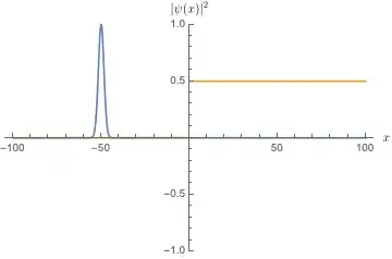

There's a reason this is not usually covered in a first pass through scattering theory - even in the simplest cases, it's a mess. If you assume that $A(k)$ is sharply peaked around some $k_0$, then you can make some reasonable approximations and end up with a not-so-horrible result - I've done so, and plotted the result below as a GIF (you may need to click on it, depending on your browser).
The other reason this level of detail is rarely covered in a first course is that it simply isn't necessary for quite a few problems of interest. In particular, finding the non-normalizable "eigenstates" $\phi_k(x)$ is enough to tell you how much reflection and how much transmission you can expect at a given $k$. In higher dimensions, these eigenstates tells you what how much scattering to expect at various scattering angles.
All of this information holds for (unphysical) particles with exact momentum $k$, but it extends approximately to particles with momentum which is peaked at $k$, and often times this is all the information you need. The only thing I gained from the work I did, for example, is a nice little movie of a bump moving along a line.
