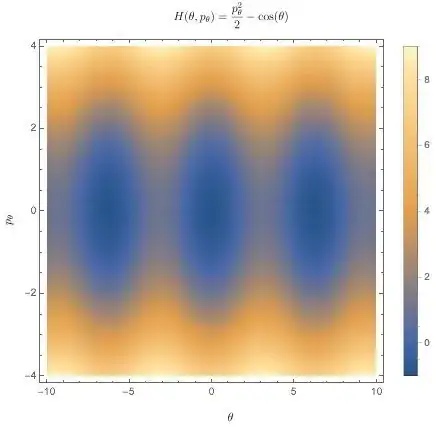

The non-relativistic spacetime symmetry group consists of translations, rotations, and Galilean boosts; those are the operations under which Newtonian physics is invariant. In the Hamiltonian formulation of mechanics, these symmetry transformations are manifested as flows through phase space, which are generated by observables. Briefly, one starts with an observable $F$ which is a smooth function of your $x$'s and $p$'s. As an example, I've plotted the Hamiltonian function for the standard pendulum below.
Each smooth function $F(x,p)$ induces a Hamiltonian vector field $\mathbf X_F$ given by
$$\mathbf X_F = \pmatrix{\frac{\partial F}{\partial p}\\-\frac{\partial F}{\partial x}}$$

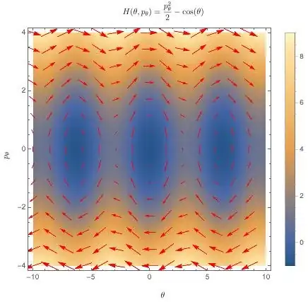

For the Hamiltonian plotted above, that looks like this: enter image description here

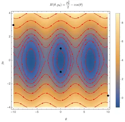

From here, we can define a flow by "connecting" the arrows of the vector field, creating streamlines:
The flow $\Phi_F$ generated by $F$ is the map which takes phase space points and pushes them along their respective streamlines, as shown here. Note: this is an animated GIF, and you may need to click on it.
