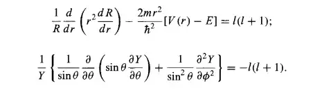

Now lets do the same calculation in spherical coordinate and derive the wave function. In Spherical equations take the following form with $\psi(r,\theta,\phi)=R(r)Y(\theta,\phi)$:
Now the angular part, $Y$, I can take it as constant, and $l=0$ as there is no angular momentum. Now if I solve now the radial part using the substitution $u=rR(r)$, and $V=0$, I get $u=Ce^{ikr}+De^{-ikr}$, and hence $R=\frac {1}{r}(Ce^{ikr}+De^{-ikr}).$
