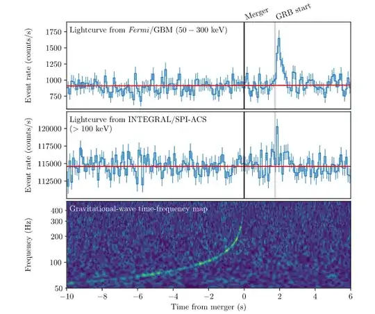

Here's a recent science update to this question: Gravity propagates at the speed of light at least to a precision of one part in $10^{15}$. This has been measured directly in 2017 when a Binary Neutron Star Merger happened that was both seen in gravitational waves (GW170817) and in gamma rays (GRB 170817A). In particular, here is Figure 2 from that paper:
The gravitational wave and gamma ray signals from a Binary Neutron Star Merger
While the neutron star merger happened across a cosmological distance of some 100 million light years, the light and gravitational wave signal were seen within a couple seconds. The ratio of these two numbers thus directly gives an upper limit on the difference of the speed of light and gravitational waves. See also this viewpoint for some context of why this measurement is really qualitatively different from anything done before, and in short, pretty cool.
