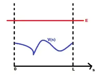

Now using the WKB method, considering $L=2\pi R$ the length of the ring and $s$ the distance travelled by the particle, for $E > V(s)$, being $V(s)$ any potential we get $$\Psi(s) = \frac{1}{\sqrt{p(s)}}(C_+ e^{i \phi (s)} + C_- e^{-i \phi (s)}) \tag{1. a}$$ or similarly $$\Psi(s) = \frac{1}{\sqrt{p(s)}}(A\, cos(\phi (s)) + B\, sin(\phi (s))) \tag{1. b}$$ with $$\phi(s) = \int_0^s p(s') ds'$$ and $$p(s)=\sqrt{2m(E_n - V(s))}$$
$\hskip1.95in$ enter image description here
After the boundary conditions $\psi(s) = \psi (s + L)$, or equivalentely $\psi(0) = \psi (L)$, the quantization for the eigenvalues is obtained $$\int_0^L p(s') ds' = n h \tag{2}$$ since $p(s)>0$, we obtain $n=1, 2, ...$ by evaluation of ($2$).
Physically speaking we could think of a particle moving in the counter clockwise direction ($s=0 \rightarrow s=L$) regarding ($2$). Inverting direction and the eigenvalues $E$ would remain the same, but now we have $n=-1, -2, ...$ There's degeneracy like the example above with $n=\pm 1, \pm 2, ...$ however $n=0$ doesn't exist here (for it regards to $p=0$ and the WKB approximation doesn't apply). The degeneracy is sustained by the fact that in ($1$) there exists two linearly independent solutions.
My question is: How can I obtain the wavefunction ($1.b$) for each value $E_n$? Either obtaining the constants ($A$ and $B$) or a more elegant expression.

  1. For the case $V=0$, note that the semiclassical WKB approximation cannot be trusted for the ground state $n=0$ corresponding to zero momentum $p=0$, or equivalently, infinite de Broglie wavelength $\lambda=h/p=\infty$.
  2. More generally, the semiclassical WKB approximation typically estimates the ground state poorly, cf. e.g. this Phys.SE post.
  3. For a derivation of the WKB approximation and its limitations, see references in this Phys.SE post.
