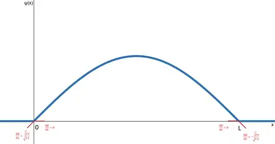

If you consider the differentiability of the wavefunction at the boundary from inside an infinite square well, you find: $\frac{d\Psi(x)}{dx}$ = $\sqrt{\frac{2}{L}}\frac{\pi}{L}$ as $x\rightarrow0^{+}$, and $\frac{d\Psi(x)}{dx}$ = $-\sqrt{\frac{2}{L}}\frac{\pi}{L}$ as $x\rightarrow L^{-}$. Outside the well, you obtain: $\frac{d\Psi(x)}{dx} = 0$ at $x=0$ and $x=L$. The derivatives do not match, hence the function is not differentiable at either boundary of the well.
This is easily seen by graphing the hybrid wavefunction (for say the ground state, $n=1$) and noting the sharp points.
