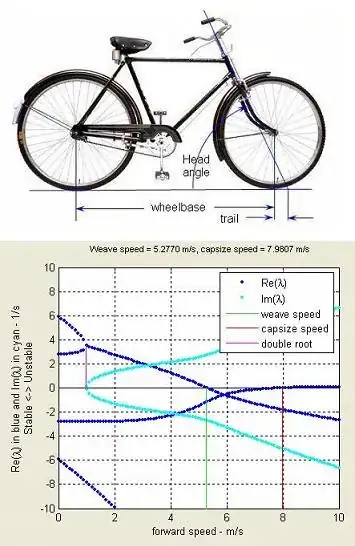

Second, the more general question of what stabilizes a bicycle is answered most thoroughly by the material on Andy Ruina's website (who admittedly was late with his post). Long story short, this is a non-trivial topic, but rigorous analysis is possible with some effort, and such analysis has been done, most importantly by Ruina's group at Cornell. Their stability analysis clearly shows the effect of a number of factors of the bicycle geometry. And, yes, of course, steering angle and rake plays a role, too, as well as other factors.
I note that Ruina even provides a piece of software (JBike6) people can use to perform such stability analyses themselves. Here is an example of its output:
We can clearly see how one of the eigenvalues crosses into the unstable region as the bicycle speed is reduced. In this case the bike becomes unstable at a "weave speed" of about $5.3\,\mbox{m/s}$.
In general, different modes of instability are possible. As an example, additional modalities of instability can arise when there is a rider steering the bicycle. For example, certain road bikes experience high-speed instabilities (the so-called "high-speed wobble") as well, which are due to the interaction of the rider with the bicycle. In this case frame flexibility is an important factor. One of my road bikes did this at speeds above about $40\,\mbox{mph}$. Not fun...
