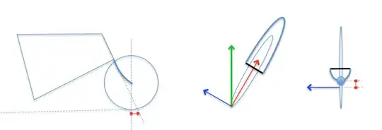

Since you asked for a vector diagram, here it is (the first is borrowed from my earlier answer):
On the left is a "bicycle", showing the bent fork. Note the red line - it indicates the "tail" - the distance between the axis of steering, and the contact point between wheel and ground.
In the middle is a view of the front wheel as it tilts, showing that there will be a torque on the wheel
On the right is a view of the front wheel along the steering tube: now you can see that the reaction force of the road causes the wheel turns to the right when the bike tilts to the right.
And when the wheel turns to the right, there will be a restoring torque that keeps the bike from falling over...
