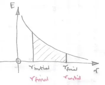

When you are evaluating $\vec E \cdot \Delta \vec l$ you are really evaluating work done on a unit positive charge by an external force $\vec E$ when the displacement of the force is $\Delta\vec l = \vec r _{\rm final} - \vec r_{\rm initial}$.
This is the area under a force against displacement graph, the complication being that $\vec E$ varies with position.
If $\vec E = E \,\hat r$ and $\Delta \vec l = (r _{\rm final} - r_{\rm initial})\,\hat r$ and remembering that $E$ varies with position $\vec E \cdot \Delta\vec l \approx E \,(r _{\rm final} - r_{\rm initial})= E\, \Delta r$.
Note here that I am not interested in the exactly magnitude of this quantity but I am very interested as to whether its value is positive or negative.
So let's look at the graph of $E$ against $r$.
What is the area under this graph $\approx E \,(r _{\rm final} - r_{\rm initial})$?
You will immediately see that it depends on whether you follow the gray labels ($r$ increasing) or the red labels ($r$ decreasing).
With the grey labels the area is positive because $r _{\rm final} - r_{\rm initial} > 0$, ie $\Delta r >0$, and $E$ is positive whereas with the red labels the area is negative because $r _{\rm final} - r_{\rm initial} < 0$, ie $\Delta r <0$, and $E$ is positive.
The way you evaluate this area exactly is by evaluating an integral $\int^{r_{\rm final}}_{r_{\rm initial}}E \,dr$ which is just the limit as $\Delta r$ tends to zero of a sum with terms like $E \,(r _{\rm final} - r_{\rm initial}) = E \,\Delta r$.
And is $(r _{\rm final} - r_{\rm initial})=\Delta r$ positive or negative in this sum?
That is completely determined by the limits of integration.
So you must write $d \vec l = dr \,\hat r$ and the sign of $dr$ will be determined by the limits of integration.
In your example, with the lower limit as infinity and the upper limit as $r$, the integral is negative (ie the process of integration is "using" negative $dr$) and so the change in the potential is positive as expected.
