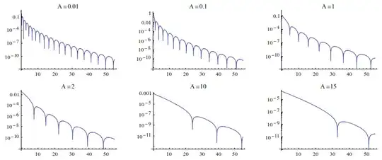

Since $K_\nu$ is real here, for whatever reason, we can ask for its zeros. As with all Bessel zeros there is no chance of an elementary formula for them, but they can be found quite easily using numerical methods (for properties of the zeros, see this DLMF reference). For a taster, here are some graphs, in log-linear scale (so zeros show up as downward, log-like peaks), of $K_{2i\sqrt{E}}(2\sqrt{A})$ as a function of $E$, for a few different values of $A$.
While there isn't all that much to say about the energies from this, it is clear that there are a countable infinity of them, that they are bigger than $A$, and that their spacing increases with increasing $A$ and $n$ (why?) - but that's really all you'd really want to know!
