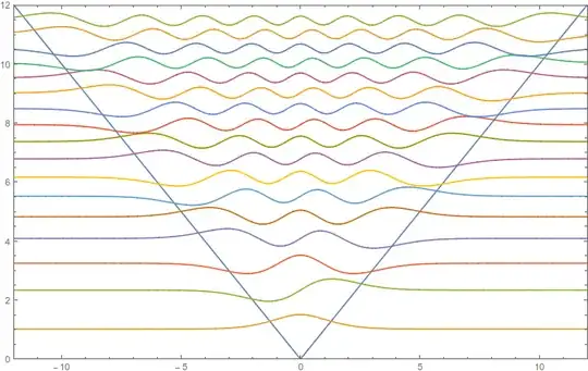

with $\psi_n(x)$ set to a properly normalized wavefunction of the form $\mathrm{Ai}(|x|-b)$ with $b$ set to a zero of the Airy function of its derivative, then the eigenfunctions are obviously right,
Plot[
 Evaluate[Join[{Abs[x]},
   Table[-b[n] + 0.7 ψ[n, x], {n, 0, 16}]
 , {x, -12, 12}
 , Frame -> True
 , Axes -> False
 , ImageSize -> 700
 , PlotRangePadding -> None
Mathematica graphics

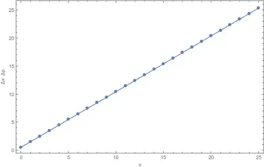

The uncertainty product can be integrated numerically, via
Table[{n, Sqrt[
   NIntegrate[x^2 ψ[n, x]^2, {x, -∞, ∞}]
    NIntegrate[Evaluate[
      -D[ψ[n, x], {x, 2}] /. {Sign'[_] -> 0, Sign''[_] -> 0}]
     ψ[n, x], {x, -∞, ∞}]]}
  , {n, 0, 25}];
and it looks like this,
i.e. obviously very, very linear. (As an interesting aside, the ground state obviously satisfies the uncertainty principle, at $\Delta x\Delta p = 0.50463\cdots$, but as a plus it is also rather close to the minimal value.)

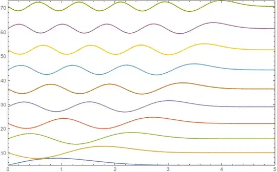

Just for fun, let's try another analytically-solvable potential, the exponential potential $$V(x)=A\exp(x),$$ bound on the left by the condition $\psi(0)=0$. The eigenfunctions of this problem are derived in the linked question to be of the form $$\psi_n(x)=C_nK_{2i\sqrt{E_n}}\left(2\sqrt{A}e^{x/2}\right),$$ where the quantization condition forces the energies $E_n$ to obey the equation $$K_{2i\sqrt E}(2\sqrt{A})=0.$$ This is relatively straightforward to code, using
ψ[e_, A_, x_] := Sqrt[2 Sqrt[e] Sinh[2 π Sqrt[e]]]
                     BesselK[2 I Sqrt[e], 2 Sqrt[A] Exp[x/2]]
and the spectrum via
getSpectrum[A_, max_: 200] :=
 getSpectrum[A, max] = getSpectrum[A] = Sort[
    Re[e] /.
     FindComplexRoots[
      BesselK[2 I Sqrt[e], 2 Sqrt[A]] == 0, {e, 0 - 0.1 I,
       max + 0.1 I}, SeedGenerator -> RandomSobolComplexes,
      Tolerance -> 10^-5]
using the FindComplexRoots function from this package, documented here, giving wavefunctions that look something like

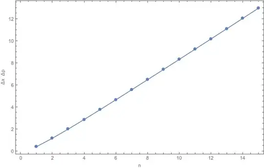

for $A=1$, and with the uncertainty products being numerically integrable using
Column@AbsoluteTiming[
  data = Table[
    Sqrt[NIntegrate[x^2 f^2, {x, 0, ∞}] -
      NIntegrate[x f^2, {x, 0, ∞}]^2] Sqrt[
     NIntegrate[D[f, x]^2, {x, 0, ∞}] -
    , {f, (ψ[getSpectrum[1, 200], 1, x]/norm[1])[[1 ;; 15]]}]
looking like
which is again very linear.
