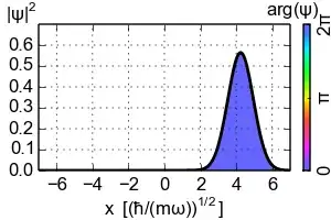

So where does the Ehrenfest theorem lead to the classical dynamics? You need to consider the localized wavepackets. The simplest example would be the coherent state of the Harmonic oscillator that is the Gaussian wavepacket that follows the classical trajectory Coherent state evolution
For the Harmonic oscillator the Ehrenfest theorem is always "classical" if only in a trivial way (as in case of the eigenstates). However in general the Ehrenfest theorem reduces to the classical equation of motion only on such localized wavepackets that concentrate near the classical trajectory as $\hbar$ goes to zero. The key point happens to be the interchange $\langle V'(x)\rangle \mapsto V'(\langle x\rangle)$ that on general states can't be done. So if you want to recover some classical dynamics from the quantum theory look on the localized wavepackets.

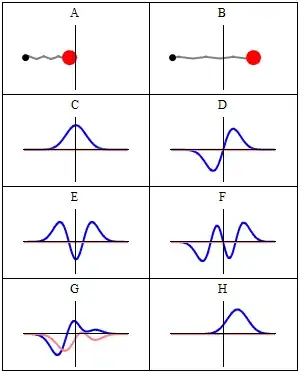

  2. Be careful about the time dependence of your reported $\psi$: you're actually dealing with $\Psi(x, t)=\psi(x)e^{-itE/\hbar}$ for those stationary states. Of course, this doesn't relate to the Ehrenfest theorem, but it's something worth mentioning: the complex and real parts are oscillating, as shown by the pink and blue lines in this diagram (from the wikipedia page on QHO):complex and real parts of some QHO states
    Do not make the mistake of suggesting that all derivatives with respect to time are necessarily automatically equal to zero because the wavefunction is time-independent. Contrary to what the shorthand notation suggests, we do have a (separable) time-dependent bit.
  3. Referring to the same diagram, observe parts G and H: these represent coherent states, which can be understood using Ehrenfest's theorem because $|\psi|^2$ looks like a Gaussian which follows a classical $\sin$ or $\cos$ function.
