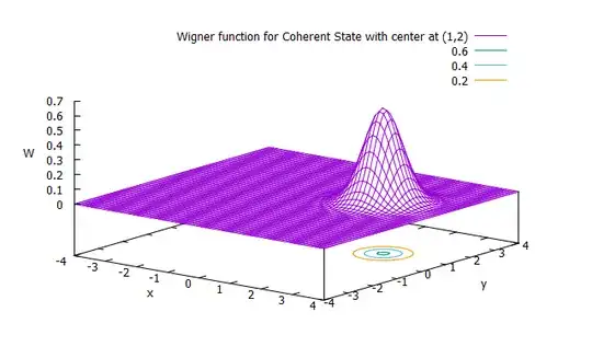

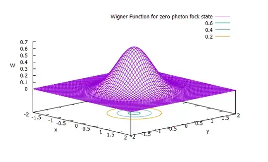

Coherent States of Harmonic Oscillator are Quantum Mechanical states which have definite phase and Minimum Uncertainty. The Quantum Mechanical states of Harmonic Oscillator do not have definite phase (i.e,one photon being in phase with another photon is not valid in Quantum mechanics) so we need a Quantum Mechanical state to model a coherent laser light (which is thought of many light sources in phase with each other).
The Coherent state of Harmonic Oscillator can be obtained by a displacement operator acting on vacuum state $$ D|0\rangle=|\alpha\rangle$$ Where $$D=e^{(\alpha{a}^{\dagger}-\alpha^*a)}$$ The Coherent State is defined as, $$|\alpha\rangle=e^{\frac{-|\alpha|^2}{2}}\sum_{n=0}^{\infty} \frac{\alpha^n}{\sqrt{n!}}|n\rangle$$ Where $\alpha=|\alpha|e^{i\theta}$ is a complex number with '$\theta$' the phase of the coherent state.
The Coherent States obey Uncertainty relation, $$\Delta{x}\Delta{y}=\frac{\hbar}{2}$$
The Ground state of HO do not have any definite phase, so the gaussian is centered at origin in phase space. But the Coherent state has a definite phase so the gaussian is not necessarily centered at the origin. Ground State of Harmonic Oscillator in Phase Space Coherent State in phase space
