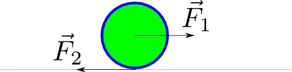

Suppose that $\vec{F}_1$ is the force produced by the biker and $\vec{F}_2$ is the friction due to the floor.
Let $m$ be the mass of the wheel, $I$ its moment of inertia, $R$ its radius, $a$ its acceleration along $x$ and $\alpha$ its angular acceleration.
We know that:
$$\begin{cases} ma =F_{1,x} - F_{2,x}\\ I\alpha = -RF_{2,x}\\ a + R\alpha = 0 \end{cases}.$$
The equation $a + R\alpha = 0$ means that the wheel does not slip on the floor.
We can find the three unknown of such system, namely $a$, $\alpha$ and $F_{2,x}$:
$$\begin{cases} a =\displaystyle\frac{F_{1,x}R^2}{mR^2 +I}\\ \alpha = -\displaystyle\frac{F_{1,x}R}{mR^2 +I}\\ F_{2,x} = \displaystyle\frac{F_{1,x}I}{mR^2 +I}\\ \end{cases}.$$
As expected, a "narrower" wheel, i.e., smaller $m$ and hence a smaller $I$, implies an higher acceleration $a$. Indeed, the denominator of $a$ depends on both $m$ and $I$.
