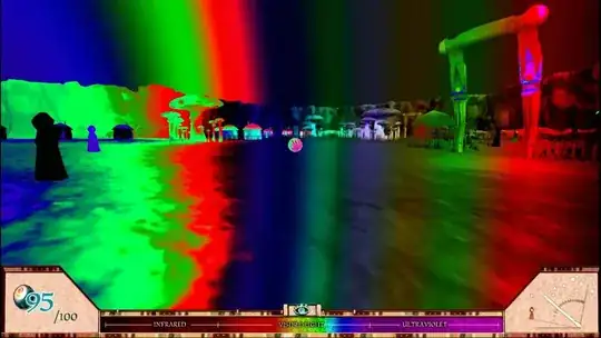

Here's a screenshot from the game:
Here's a similar screenshot taken at rest, to which I applied a "Doppler gradient" using Doppler shift code from Backlight, the 4D raytracer:
I certainly wouldn't take the second image as definitive, but it's qualitatively much closer to how the game ought to look. White objects illuminated by starlight have roughly a blackbody spectrum, so when Doppler shifted they should be red, white, or blue, never green or purple. Objects with desaturated colors should appear as desaturated rainbows (look at the ground, which is pale blue at rest). And the brightness should increase smoothly as you look from right to left.
The game isn't open source, but the Doppler shift shader is, so I took a look at it.
It works by guessing a light spectrum (represented as a sum of Gaussians in wavelength space) from the RGB components of the texture, scaling it by the Doppler shift factor, convolving it with approximations of the XYZ color matching functions (also sums of Gaussians), then converting XYZ to RGB. That's reasonable.
The first problem is that instead of guessing a broad spectrum that approximates a solar blackbody when the color is grey/white, they guess narrow spikes at 463nm, 550nm, and 615nm. That just isn't realistic, and it's the reason for all the weird colors in the right half of the screenshot.
The bright colors on the left are due to another strange design decision. Along with RGB they support IR and UV color channels which can be seen only when they're Doppler shifted into the visible range, which is a good idea. But they're again sharp spikes in the spectrum, and the textures control the wavelength of the spikes, while the amplitudes are fixed. For UV, you choose a wavelength from 0nm to 380nm (effectively an infinite range), while for IR it's 700nm to 1100nm (less than a 2:1 range). The reason you see bright RGB rainbows in every texture when blueshifted, but not when redshifted, has nothing to do with physics. It's because you can put the mandatory UV spike at 0nm where it will never be visible, but you can't hide the mandatory IR spike.
The brightness scaling appears to be wrong also. They multiply the width of the Gaussians by the redshift factor, which scales the integrated energy by the same factor, then they divide by the redshift factor cubed. As a result their Stefan-Boltzmann law is $σT^2$ instead of $σT^4$. They should have divided by the fifth power.
There also seem to be problems with the spectrum-to-RGB conversion code—the rainbow on the left would have ROYGBIV stripes, not just RGB, if converted correctly.
Another minor problem is they seem to calculate the effects based on how hard you're pushing the joystick, not how fast you're actually moving. E.g., the moving ghosts appear red/blueshifted when you're stationary, but if you stand in front of one and let it push you, it remains blueshifted though it's now stationary relative to you, and there are no motion effects on the background even though it's moving. The red/blueshift of the ghosts also doesn't seem to change as the speed of light ostensibly decreases.
The "what's going on" supplement at the end (also downloadable in Powerpoint format from the web site) has some mistakes.
Light also behaves like a stream of particles called photons. When you run towards a stream of photons, more photons hit you and the object becomes brighter. This effect is also known as Relativistic Aberration.
First, these effects are classical so quantization is irrelevant. Second, increased rate of photon absorption only accounts for a small part of the brightness increase. Third, aberration refers to a change of angle, not to more photons hitting you.
On this slide there's also an image captioned "moving left, the objects on the left are brighter than the objects on the right", even though that plainly isn't true in the image (which is similar to the image at the top of this answer). It should be true, of course. It's difficult for me to understand how they never at any point in development figured out that their shader was buggy given its crazy output.
