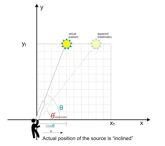

If observer moves with velocity v, and receives pulse of light at points of closest approach with the source (at this moment the source actually is over his head, in zenith, at angle $\theta = 0$) he will see this source at angle $\tan \theta’= \frac {v/c} {\sqrt {1-v^2/c^2}}$. While vertical distance travelled by light will be $ct$, horizontal travelled by observer will be $vt$. That means, that in classical case if observer moves with velocity $v=c$, maximum angle would be $\pi/4$ but in relativistic case (if $v$ is very close to $c$) due to length contraction of measuring rod of the observer the source appears to be much further, almost in the front of him on the horizon at angle $\sin \theta'=v/c$.
34.8. Aberration: http://www.feynmanlectures.caltech.edu/I_34.html enter image description here
Further we plot the angle from the abscissa axis:
$$\tan \theta’ = \frac {\sin \theta} {\gamma (\cos \theta + v/c)} = \frac {\sin \theta \sqrt {1-v^2/c^2} } {\cos \theta + v/c}$$
