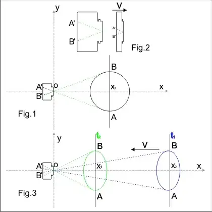

It seems that it should look like that (at first glance), maybe someone can say something in addition or to find something that I have missed:
The picture should not depend on chosen frame.
Let's think about a photocamera moving toward illuminated sphere (or vice versa)
If the camera moves towards illuminated sphere there are the following effects: contraction of the camera and motion of the film towards object, while light travels inside the camera.
So, we can compare pictures of "stationary camera" wrt sphere (Fig. 1) and "moving camera" wrt sphere (Fig.2) when they coincide, I mean their pinholes coincide. At this moment, when the shutter briefly opens, the same information goes through the aperture. Patches of light rays from edges of the sphere to aperture and from aperture to the film form similar triangles. Since camera Lorentz - contracts and the film moves forward, image should appear smaller on the film that corresponding image as taken by "stationary" camera wrt sphere at this point.
If we work in the camera frame, if the sphere moves towards camera (Fig. 3), it seems that there is light - time correction, and we see the sphere "in the past", blue rays, since "green" rays from its current position have not reached the camera yet.
At first glance, it looks like that.
