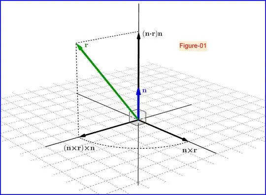

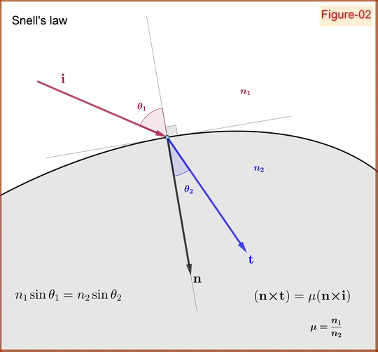

Let a unit vector $\;\mathbf{n}=(\rm n_1,n_2,n_3)\,, \Vert\mathbf{n}\Vert=1$. Any vector $\;\mathbf{r}\;$ could be decomposed in two components with respect to $\;\mathbf{n}\;$, see Figure-01 in the bottom \begin{equation} \mathbf{r}=\mathbf{r}_\|+\mathbf{r}_\bot \tag{01}\label{01} \end{equation} one parallel and the other normal to axis $\mathbf{n}$ respectively \begin{align} \mathbf{r}_\| &=\left(\mathbf{n}\boldsymbol{\cdot}\mathbf{r}\right)\mathbf{n} \tag{02.1}\label{02.1}\\ \mathbf{r}_\bot &=\left(\mathbf{n}\boldsymbol{\times}\mathbf{r}\right)\boldsymbol{\times}\mathbf{n}= \mathbf{r}-(\mathbf{n}\boldsymbol{\cdot}\mathbf{r})\mathbf{n} \tag{02.2}\label{02.2} \end{align} that is \begin{equation} \mathbf{r}=\left(\mathbf{n}\boldsymbol{\cdot}\mathbf{r}\right)\mathbf{n}+\left(\mathbf{n}\boldsymbol{\times}\mathbf{r}\right)\boldsymbol{\times} \mathbf{n} \tag{03}\label{03} \end{equation} The vectors $\;\mathbf{t},\mathbf{i}\;$ are decomposed as follows \begin{equation} \mathbf{t}=\left(\mathbf{n}\boldsymbol{\cdot}\mathbf{t}\right)\mathbf{n}+\left(\mathbf{n}\boldsymbol{\times}\mathbf{t}\right)\boldsymbol{\times} \mathbf{n} \tag{04}\label{04} \end{equation} \begin{equation} \mathbf{i}=\left(\mathbf{n}\boldsymbol{\cdot}\mathbf{i}\right)\mathbf{n}+\left(\mathbf{n}\boldsymbol{\times}\mathbf{i}\right)\boldsymbol{\times}\mathbf{n} \tag{05}\label{05} \end{equation} Now, Snell's Law is expressed as \begin{equation} \left(\mathbf{n}\boldsymbol{\times}\mathbf{t}\right)=\mu\left(\mathbf{n}\boldsymbol{\times}\mathbf{i}\right) \tag{06}\label{06} \end{equation} see Figure-02 in the bottom.
Equation \eqref{04} combined with \eqref{05} and \eqref{06} yields \begin{equation} \mathbf{t}=\left(\mathbf{n}\boldsymbol{\cdot}\mathbf{t}\right)\mathbf{n}+\mu\left[\mathbf{i}-\left(\mathbf{n}\boldsymbol{\cdot}\mathbf{i}\right)\mathbf{n}\right] \tag{07}\label{07} \end{equation} Taking norms in \eqref{07} and since the vector $\;\left(\mathbf{n}\boldsymbol{\cdot}\mathbf{t}\right)\mathbf{n}\;$ is normal to the vector $\;\left[\mathbf{i}-\left(\mathbf{n}\boldsymbol{\cdot}\mathbf{i}\right)\mathbf{n}\right]\;$ \begin{equation} \Vert\mathbf{t}\Vert^2=\left(\mathbf{n}\boldsymbol{\cdot}\mathbf{t}\right)^2+\mu^2\Vert\mathbf{i}-\left(\mathbf{n}\boldsymbol{\cdot}\mathbf{i}\right)\mathbf{n}\Vert^2 \tag{08}\label{08} \end{equation} or \begin{equation} 1=\left(\mathbf{n}\boldsymbol{\cdot}\mathbf{t}\right)^2+\mu^2\left[1-\left(\mathbf{n}\boldsymbol{\cdot}\mathbf{i}\right)^2\right] \tag{09}\label{09} \end{equation} so \begin{equation} \left(\mathbf{n}\boldsymbol{\cdot}\mathbf{t}\right)=\pm\sqrt{1-\mu^2\left[1-\left(\mathbf{n}\boldsymbol{\cdot}\mathbf{i}\right)^2\right]} \tag{10}\label{10} \end{equation} Since the angle between $\;\mathbf{n},\mathbf{t}\;$ is less than $\;\pi/2\;$ we keep the plus sign in \eqref{10} and \eqref{07} yields finally \begin{equation} \mathbf{t}=\sqrt{1-\mu^2\left[1-\left(\mathbf{n}\boldsymbol{\cdot}\mathbf{i}\right)^2\right]}\,\mathbf{n}+\mu\left[\mathbf{i}-\left(\mathbf{n}\boldsymbol{\cdot}\mathbf{i}\right)\mathbf{n}\vphantom{\left(\right)^2}\right] \tag{11}\label{11} \end{equation}
