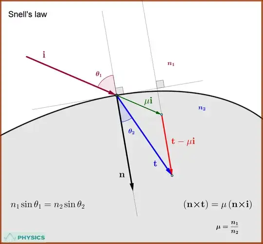

Is there a simple way to reverse the Snell's-Equation-in-Vector-Form problem? I.e., given the incident and transmitted vectors $\,\mathbf{i}\,$ and $\,\mathbf{t}\,$ (both with norm = 1), find the normal vector of the boundary surface (between media with refr. indices n1 and n2, resp.) required to achieve the desired change of direction through refraction? I haven't found a simple solution, yet, after trying for an hour and a half. (I get a messy system of coupled non-linear equations.) The "forward" problem is discussed and solved here: Snell's law in vector form
This could be useful for finding and orienting a prism to bend a given ray into a desired direction.
