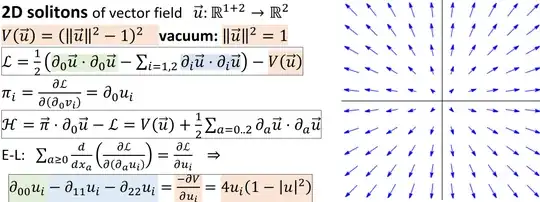

Clarification: I see nobody defends vacuum polarization explanation, but there are lots of "impossibility claims" and avoiding answers, so let me briefly elaborate on solution to this problem suggested by topological solitons.
Let's look at the simplest vector field in 2D with Higgs-like potential to prefer unitary vectors: enter image description here
Requiring unitary vectors, $u(x)=x/|x|$ configuration would also have infinite energy due to discontinuity in the center. As in the diagram, it is regularized by getting out of minimum of Higgs potential (unitary vectors) - up to zero vector in the center, allowing to realize such topological charge using only finite energy.
To recreate electromagnetism in 3D for topological charges as electric charges, we can use Gauss-Bonnet theorem in place of Gauss law: it says that integrating curvature over a closed surface, we get topological charge inside this surface.
So interpreting curvature of a deeper field as electric field (analogously B), and using standard Lagrangian for it, we can recreate electromagnetism with two corrected issues: Gauss law allowing only integer (topological) charge (included charge quantization), and with charges containing only finite energy - some article.
Is there a problem with such explanation of finite energy of a charge, or maybe there are some better explanations?
