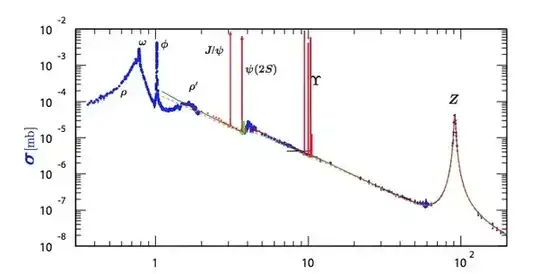

Another argument for point nature of electron is tiny cross-section, so let's look at it for electron-positron collisions:
Beside some bumps corresponding to resonances, we see a linear trend in this log-log plot: $\approx 10^{-6}$ mb for 10GeVs (5GeV per lepton), $\approx 10^{-4}$ mb for 1GeV. The 1GeV case means $\gamma\approx 1000$, which is also in Lorentz contraction: geometrically means $\gamma$ times reduction of size, hence $\gamma^2$ times reduction of cross-section - exactly as in this line on log-log scale plot.
More proper explanation is that it is for collision - transforming to frame of reference where one particle rests, we get $\gamma\to\approx \gamma^2$. This asymptotic $\sigma \propto 1/E^2$ behavior in colliders is well known (e.g. (10) here) - wanting size of resting electron, we need to take it from GeVs to E=511keVs.
Extrapolating this line (no resonances) to resting electron ($\gamma=1$), we get $\approx 100$ mb, corresponding to $\approx 2$ fm radius.

''There is some confidence that electron is a perfect point e.g. to simplify QFT calculations.'' No. In QED, electrons are only point-like, which makes quite a difference. In the context of scattering experiments, the electron size is determined by the form factors, which are not those of a point particle, due to radiative corrections. For details and references see several articles in Chapter B2: Photons and Electrons of my Theoretical Physics FAQ.
Note that while it is undisputed that the electron is not a point, there is no longer a single measure of size. Depending on the details how you define the concept of a radius you get different answers.
The particle data group (the official source for particle properties) lists on p.109 of its 2014 report the value $2.8\cdot 10^{-15}m$ as ''classical electron radius''.
This is one possible measure of size; how useful it is depends on what you want to do with the value....
