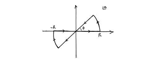

The objective is to compute $\psi(x,t)$, which amounts to carrying out the $y$ integral in the above boxed formula. This is a Gaussian and so can easily be carried out. You'll primarily need the result: $$ \int_{-\infty}^{\infty} da\,e^{iza^2} = \sqrt{\frac{\pi i}{z}},\quad {\rm if }\quad {\rm Im}\,z\geq0,\quad z\neq0, $$ which follows from Cauchy's theorem applied to $\oint_C da\,e^{iza^2}=0$, where the contour $C$ is that in the figure: C contour It is convenient to write $z=\rho e^{i\phi}$ (with $0\leq \phi<\pi$), and then given any allowed $\phi$ you choose $\theta$ such that $\phi+2\theta=\pi/2$. This enables you to take $R\rightarrow \infty$ while ensuring the angular contour contributions vanish, and you are left with $\int_{-\infty}^{\infty}da\,e^{iza^2}=\sqrt{i}e^{-i\phi/2}\int_{-\infty}^{\infty}da\,e^{-\rho a^2}$. Evaluating the remaining Gaussian integral and rewriting the result in terms of $z=\rho e^{i\theta}$ leads to the displayed result.
