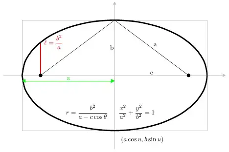

A parabola and an ellipse are both conic sections, which can be constructed in a plane as all the points where the distances from some reference point (the "focus") and some reference line (the "directrix") have some ratio $e$ (the "eccentricity"). An ellipse has $0<e<1$ a parabola has $e=1$.
In a typical intro physics "Billy throws a baseball"-type problem, the distance between the focus and the directrix for the "parabolic" trajectory might be a few meters. If the trajectory is secretly an ellipse due to Earth's gravity, Kepler's Laws predict that the other focus of the ellipse is the Earth's center of mass, and symmetry requires the path goes only a few meters from that point as well. That means we can estimate the eccentricity directly. Using the standard notation,
Conic section - standard forms of an ellipse
By Klaas van Aarsen [GFDL or CC BY-SA 3.0], via Wikimedia Commons
we have semimajor axis $a$ about half of Earth's radius $\rm 10^{6.5}\,m$, the distance from the focus to the end of the ellipse $a-c$ of order a few meters, and eccentricity $$ e = \sqrt{1-\frac{b^2}{a^2}} = \frac ca \approx 1 - \mathcal O\left(10^{-6}\right). $$

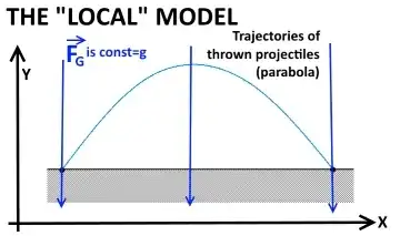

The key Point here is “…thrown near the earth’s surface…”.
That sentence usually means:
  1. Gravitational acceleration is constant and equal to $\rm g$.
  2. The ground can be considered a flat surface and gravitational force is normal to the surface.
With this 2 conditions we assume gravity as a constant force only acting on the vertical ($\rm y$) direction, or
$$\rm F_{Gy}=mg=m \frac{d^2y}{dt^2} \tag{1}$$ $$\rm F_{Gx}=0=m \frac{d^2x}{dt^2} \tag{2}$$ Solving these 2 equations one gets $$y=\rm \frac{1}{2}gt^2+v_{0y}t+y_0 \tag{3}$$ And $$\rm x=v_{0x}t+x_0 \tag{4}$$
Which is the parameterized form of a parabola with time $\rm t$ as parameter.
However, this is just the local view of the problem, meaning that you are just considering short distances when compared to earth’s radius.

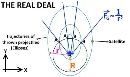

The general problem
Considering that earth is a spherical object, it is possible to demonstrate that it’s gravitational force is equivalent to the gravity of a point mass located at it’s center. The trajectories of objects moving as the result of such forces obeys Kepler’s laws, replacing the sun by the center of the round object.
Kepler’s first law says that such trajectories are in fact ellipses (one could demonstrate it by solving Newton’s second law, but I won't bother if you do that ;-)
The big difference here is that gravity is not considered constant neither in magnitude (it is inversely proportional to the distance from the object to the center of earth) nor in direction (it point towards the center all the time).
Therefore, before continuing the discussion with your friend, please make sure you guys decide whether to consider “…thrown near the earth’s surface…” or not.
