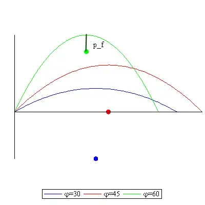

The projectile parabola is:
$$y(x)=\tan(\varphi)\,x-\frac{1}{2}\frac{g}{v_0^2\,\cos^2(\varphi)}\,x^2$$
where $$ 0 \le x \le \frac{v_0^2\sin(2\,\varphi)}{g}$$
the focus of this parabola is :
$$p_f=\frac 12\,{\frac {{v_0}^{2} \left( \cos \left( \varphi \right) \right) ^{2 }}{g}}\tag 1 $$
thus the parabola $$y(x)\mapsto \tan(\varphi)\,x-\frac{1}{4\,p_f}\,x^2$$
you can see at this diagram the parabolas and the focus points for different angles $\varphi$ and a constant projectile velocity $v_0$

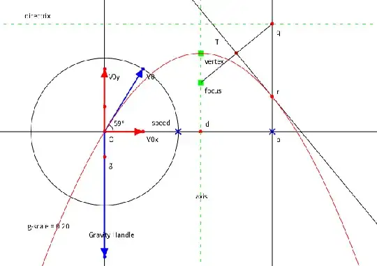

I had this same question yesterday. The derivation is pretty hard to post, but... The directrix is the height that the projectile would reach if it was thrown straight up with the same initial velocity as in your diagram.
For the parabolic motion, the kinetic energy at the top of its flight is $\frac{m(v_{0 x})^2}{2}$. And it's height is $h_1 = \frac{v_{0y}^2}{2g}$ which comes from $mgh = \frac{mv_{0y}^2}{2}$.
If you could redirect the horizontal kinetic energy into vertical, gravitational potential energy it would add a new height of $h_2 = \frac{v_{0x}^2}{2g}$.
Add the two heights h1 + h2 and you get $\frac{v_{0x}^2 + v_{0y}^2}{2g}$ which is just $\frac{v_0^2}{2g}$. And $h=\frac{v_0^2}{2g}$ turns out to be the equation for the directrix if you do it out carefully.
The height of the focus of the parabola is the same as height when the projectile is traveling at 45° up or down. I guess I should have known this before now...the latus rectum of a parabola intersects the parabola where it has a slope of +/- 1 (or 45°).
