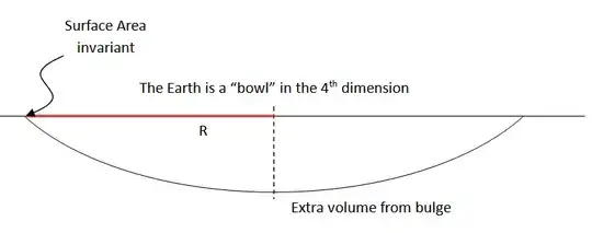

In doing the correct integral with GR we integrate about $ds$. I should note, the radius is a difficult value to pin down, as I discussed in the question. I'll use $R'$ notation, but I'm really going to continue from this point with $R'=R$. If you disagree with this, this would be the point you'd want to pick the calcs up. My position for making these radii the same is to get the circumference the same. Keep in mind, the w-axis offset of $w(r)$ is arbitrary, so I can claim it intersects the r-axis at the surface of Earth. In this way, $R$ is a straight line in 4-dimension space (3 space plus the fictitious buckling dimension) from the surface to "under" the center of the Earth. The thing that is preserved with this method is the circumference and the surface area of Earth, which are the only values Earthlings have direct measurement of. I also made an illustration to convince you of this (I needed it myself).
The Earth is a bowl

$$ \Delta V = \frac{4 \pi \alpha^2 R^5}{10} = \frac{4 G \pi^2 \rho R^5}{15 c^2} = \frac{ G M \pi R^2}{5 c^2} = 113 km^3 $$
This comes out to 113.33 km^3, or 1000 Strategic Petroleum Reserves (I stand corrected on this point). This is a common size for lakes around the world.
