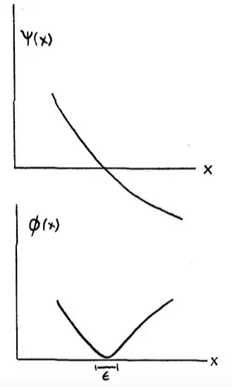

You manufacture φ to equal |ψ|, except in a symmetric region [–ε,ε] around x=0, in which we take it, instead, to be, e.g., ψ(x)=ε, suitably normalized. (The WP choice. You could make the choice smoother at the edges of the interval by more elaborate choices, without significant differences.)
Cohen thesis graph
You may then readily convince yourself that, whatever the slope of ψ through 0, the normalization of φ will exceed that of ψ by $O(\epsilon^3)$.
Crucially, the kinetic energy is lowered by $O(\epsilon)$, $$ \langle T\rangle_\psi - \langle T\rangle_\phi = \frac{\hbar^2}{2m} \int^\epsilon_{-\epsilon} dx \left ( \frac{d\psi (x)}{dx} \right ) ^2 \sim \epsilon \frac{\hbar^2}{m} \left(\frac{d\psi}{dx} (0)\right)^2, $$ times some finite fraction.
$\langle V\rangle$, however, changes by $O(\epsilon^3)$, so its contribution is subdominant, so, then, ignorable. Since $\langle E\rangle$ is lowered by $O(\epsilon)$, your nodeful ψ cannot be the ground state. In practice, the nodeless φ may be deformed further to a smoothest form avoiding energetically expensive undulations.
