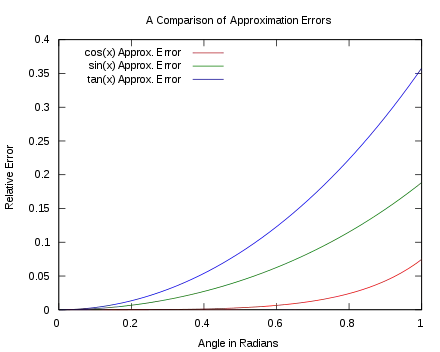

Image Source: Wikipedia
Using the approximation, you can rewrite equation $(4)$ as
$$L\frac{d^2\theta}{dt^2} = -g\theta \tag{5}$$
The above equation looks quite similar to the equation $(1)$. It does match perfectly. Therefore, for small amplitudes, the pendulum executes a simple harmonic motion with a reasonable uncertainty.

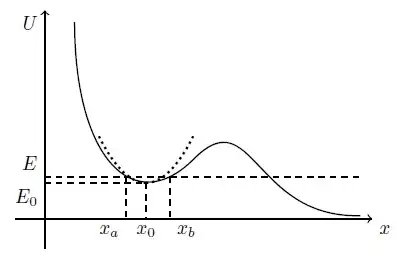

Neither a simple pendulum or a real spring has potential which is quadratic (or parabolic) around an equilibrium point. However in a small enough region around the equilibrium (zero force and minimum of the potential) we can Taylor expand the potential up to second order which just gives a parabolic potential. To understand this, consider the figure below,
This is a generic potential which is definitely not of the required form for a SHM. However, notice that we can fit a parabola (dotted line) around any stable equilibrium point such as $x_0$. In the vicinity of the equilibrium point $x_0$ we have the expansion, $$U(x)=U(x_0)+\frac{dU(x_0)}{dx}(x-x_0)+\frac{1}{2}\frac{d^2U(x_0)}{dx^2}(x-x_0)^2+\mathcal O(\Delta x^3),$$ where $\mathcal O(\Delta x^2)$ means we are neglecting terms of order $(x-x_0)^3$ or greater. Since the first derivative of the potential at $x_0$ gives the force at $x_0$ (which is zero), that term vanishes. We are left with $$U(x)=U(x_0)+\frac 12 k(x-x_0)^2++\mathcal O(\Delta x^3),$$ and since $U(x_0)$ is an irrelevant additive term, and $k=frac{d^2U(x_0)}{dx^2}$ is constant, this quadratic potential is exactly the characteristic potential of SHM. Nearby $x_0$ it gives a linear and restoring force. Note however that this approximation does not hold for arbitrary displacements. At some point $x-x_0$ is so large that higher order terms have to be taken into account.
For a simple pendulum, the potential is $-mgl\cos x$ ($x$ being an angle) whose expansion up two order two around the equilibrium $x=0$ gives a parabola. For a real spring, the potential can be even more complicated, in general it is a sum of terms $a_nx^{2n}$. Then for a small region we can drop higher order terms and keep only the leading one $a_1x^2$ which gives the Hook Law.
