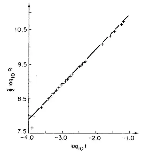

Because the argument is a dimensionless parameter, this approximation is "universal" as it does not depend on the choice of units. Taylor determined $g(0)$ using chemical (TNT) explosives for which he knew the energy $E$, and found $g(0)\approx 1$. Armed with this we then have, for small times: $$ R=\left(\frac{E}{\rho_0}\right)^{1/5}\,t^{2/5}\, \qquad t\ll 1\, . $$ A graph of $(5/2)\log(R)$ vs $\log(t)$ gives $$ (5/2)\log(R)=\log(t)+ \frac{1}{2}\log\left(\frac{E}{\rho_0}\right) $$ so, knowing $\rho_0$, one can recover $E$ from the intercept of the graph.
Trinity plot
I got the picture from a textbook on differential equations by Bluman and Kumei.
This gives $E$ equivalent to $\approx 25$kilotons of $TNT$. The actual measured energy was closer to $20$kilotons.
