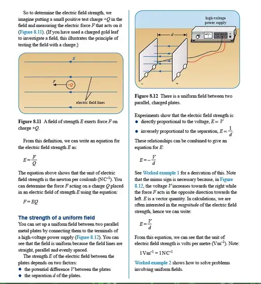

In one of the answers @user121330 mentioned that "You should provide the actual example if you want more clarity". I also mentioned in a comment below this question that I would "upload the example I spoke of"; so here it is:
Electric Fields
This is page 107 from "Physics 2 for OCR" by authors David Sang and Gurinder Chadha first published in 2009 by Cambridge University Press and has ISBN: 978-0-521-73830-9.
More information about the book can be found on their website www.cambridge.org/9780521738309

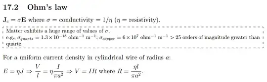

More importantly is that equation $(1)$ is also being used to derive Ohm's Law:
Ohm's Law
This was a small extract taken from my lecturer's notes.
So does it seem that electric field cannot be written as $$E=-\frac{V}{\ell}$$ or in magnitude as $$E=\frac{V}{\ell}$$ and both the book and my lecturer are wrong?
