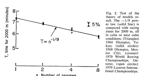

An interesting analysis related to your question on muscles was be done on rowing times. In the paper Rowing: a similarity analysis, published in Science 173.3994 (1971): 349-351 by Thomas A. McMahon, the author analyzed "why should larger boats containing many oarsmen go faster than smaller ones containing fewer oarsmen?". McMahon used dimensional analysis to show that, for similar boats, racing times should go like $n^{-1/9}$, where $n$ is the number of oarsmen. His data fits very well his model, as you can see below.
