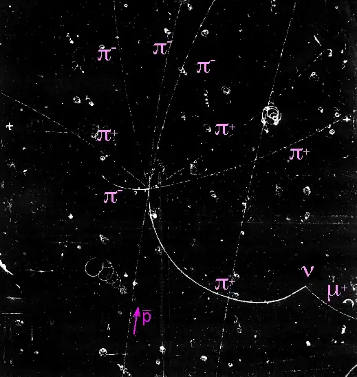

Have a look at this bubble chamber picture of proton antiproton annihilation:
This is from an actual experiment, not a thought experiment. So now what would you call these tracks? They bend in the magnetic field which is perpendicular to the plane of the picture, according to the laws of classical electrodynamics, and they all fit the mass of what is called a "pion" with a charge + or - the charge of what is called an electron, in the milikan oil drop experiment. On the lower right corner one sees an elementary particle , a muon, coming from the decay of a pion.
If it looks like a duck and it quacks like a duck it is a duck by definition, no?

So we called even pions and antiprotons "elementary particles" before discovering their compositeness with many more and more sophisticated experiments.
Our senses tell us these are "particles", at least they have the footprint of a particle and what starts at the vertex as a pion, ends at the end of the chamber as the same pion, fitted beautifully with the classical equations of motion in a magnetic field.
