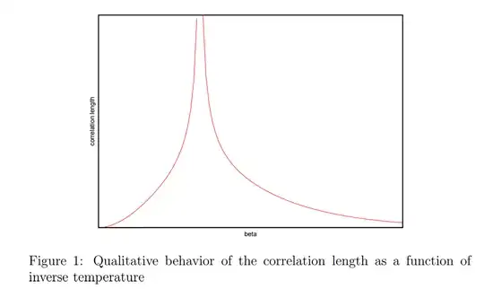

I've found a number of explanatory texts that seem to indicate that at both above and below the critical temperature $T_c$, the correlation function $C(r)$ decays exponentially at some correlation length $\xi$, and this helps us determine typical domain sizes. At $T_c$, the correlation length diverges to infinity. Here's an image from (http://math.arizona.edu/~tgk/541/chap1.pdf) to illustrate what I mean ($\beta$ of course is inverse temperature).
  1. $T > T_c$: This makes sense to me - adjacent spins are practically independent so domains are tiny, and the correlation length tends to zero as temperature increases.
  2. $T < T_c$: This doesn't make intuitive sense to me - I was under the impression that below $T_c$ the domains were large enough to ensure spontaneous magnetisation was observed. However the above is indicating that the typical correlation length ($\xi$) tends to zero as the temperature rises - and therefore domains shrink? I would have thought:
