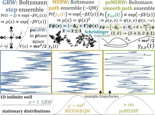

Yes, there can be found Schrödinger equation in phase-space, allowing to consider Feynman/Boltzmann ensembles of smooth paths (in contrast to standard infinite velocity diffusion-like), see e.g. https://journals.aps.org/pra/abstract/10.1103/PhysRevA.96.052116 or https://community.wolfram.com/groups/-/m/t/3124320 with Mathematica code to generate the below.
