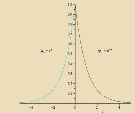

The delta-function well has just one bound state, and the energy inherent in that state is dependent on $\alpha$, the greater the value assigned to $\alpha$ is, the more negative energy results. In other words $\alpha$ acts as an indicator of the depth of a stationary state particle.
Obviously the amplitude of the location of the particle reaches its peak at 0, and then, depending on the strength of the delta function, falls away exponentially on both sides.
