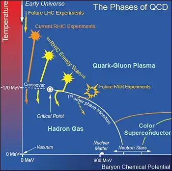

The situation is well represented in the following very pictorial picture
but this is a very active field of study. It is interesting to note that a real proof of existence for the critical endpoint (CEP, indicated as a critical point in the figure), both from a theoretical and numerical point of view, does not exist yet. The reason, at least for the lattice computations, arises from the infamous sign problem. When you discretize the action of the QCD with a chemical potential, this contribution becomes imaginary. So, several ways out have been devised but, as far as I can tell, none is taken for accepted widely. Finally, CEP is not really a critical point but a cross over point. This behaves as a true critical point for a phase transition if you take zero mass for quarks and zero chemical potential.
Note added: Just today appeared a paper by Owe Philipsen exactly on this matter (see here). The title is "Status of the QCD phase diagram from lattice calculations".
