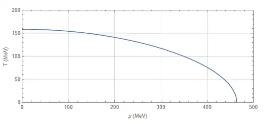

Assuming a first-order phase transition (at constant pressure) between our simplified QGP and the hadronic phase we can compute a phase transition line: $$ \begin{align} &p_\mathrm{QGP}(\mu,T)\stackrel{!}{=}p_\pi(\mu,T)\\ &\Rightarrow T_c(\mu)=\frac{\sqrt{\frac{3}{34}} \sqrt{\sqrt{340 \pi ^2 B+55 \mu ^4}-15 \mu ^2}}{\pi }.\tag{4} \end{align} $$ Using Eq. (4) we could actually fit the bag constant to the known critical temperature of QCD $T_c(\mu=0)$ or we use a literature value. For a typical literature value $B=(220\,\mathrm{MeV})^4$ we find $T_c(\mu=0)=158.\,\mathrm{MeV}$ and the following phase diagram: mu-T-Diagram

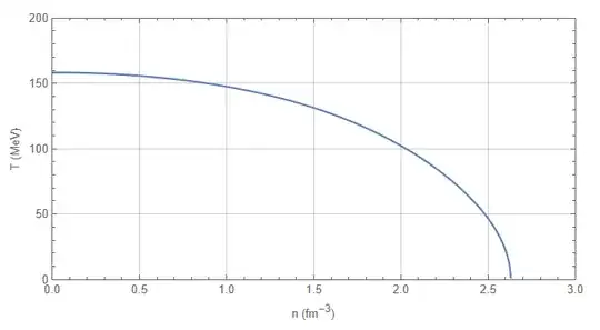

which we can translate into the $n$-$T$-plane using Eq. (2.2) with Eq. (4):
n-T-Diagram

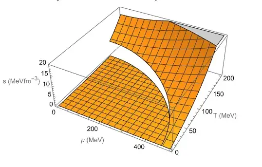

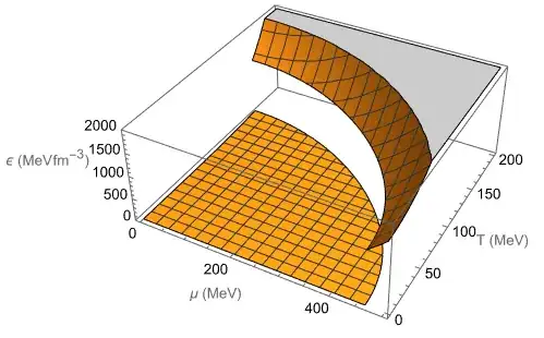

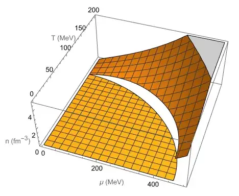

When plotting quark number density, entropy density and energy density ($\epsilon=\mu n +T s -P$) it becomes apparent that we are indeed dealing with a first order phase transition:
mu-T-n mu-T-n mu-T-epsilon
It goes without saying that this is one of the most simplistic model of a QCD like confinement-deconfinement phase transition. Concerning the phase transition line in the $\mu$-$T$ and $n$-$T$ plane: it hits all the axes at a right angle and for small $T$ we find $$ (\mu_c(T),n_c(T))=(\mu_c(0),n_c(0))*\left(1-\frac{\pi T^2}{2 \sqrt{2} \sqrt{B}}+\ldots\right), $$ with $\mu_c(T=0)=463.\,\mathrm{MeV}$ and $n_c(T=0)=2.810\,\mathrm{fm}^{-3}$ which explains the extreme similarity between both phase diagrams (up to a rescaling of the respective horizontal axis).
