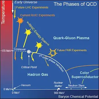

In this figure
one axis is the temperature (this one is no problem), the other one is the baryon chemical potential which causes my confusion.
Figure from here: Phase diagram of simplified QCD.
The text I'm referring to (with a similar figure): http://www.fair-center.eu/for-users/experiments/cbm/introduction.html.
Anyway, in a text about phases of QCD, the authors referred to this x-axis as the density and not the baryon chemical potential.

What is the baryon chemical potential? What does it tell me?
What does it have to do with densities? Is it just a "synonym" for densities?
Also, as far as I understood, the phases aren't like the phases of "normal" matter, e.g. hadronic matter is at 0 K and 300 million tons per cm3 (see the link for the text) in a "liquid" phase. So, what do the phases look like? Why is it "liquid" and not liquid?

If you have taken statistical mechanics, you should be familiar with the concept of chemical potential. If not, the Wikipedia article on chemical potential should be sufficient (let me know if it isn't). Essentially, chemical potential is a measure of how the energy of a system changes as you add another particle to it.
As far as its relation to density, the best answer I could find is for the case of a Fermi gas: http://www.physics.udel.edu/~glyde/PHYS825/Lectures/chapter_8.pdf. Here, it is shown that the Fermi momentum $p_F$ is dependent on density$^{1/3}$. Since the Fermi energy is proportional to $p_F^2$, it is also proportional to density$^{2/3}$. The chemical potential is proportional to the Fermi energy, so it is also proportional to density$^{2/3}$.
Baryons in the nucleus are thought to behave as a Fermi liquid, so, barring some changes in the magnitude of certain interactions, the dependency should still be there. Since baryon chemical potential rises with density, the axis labels are interchangeable without much trouble.
