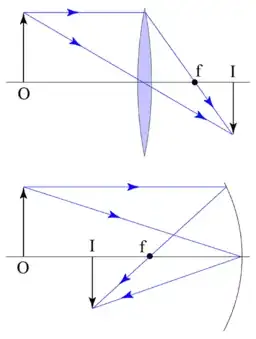

First consider the line optics of real images (from http://en.wikipedia.org/wiki/Real_image):
real images formed by a single convex lens of concave mirror
Notice that the lines that converge to form the image point are all drawn solid. This means that there are actual rays, composed of photon originating at the source objects. If you put a screen in the focal plane, light reflected from the object will converge on the screen and you'll get a luminous image (as in a cinema or a overhead projector).

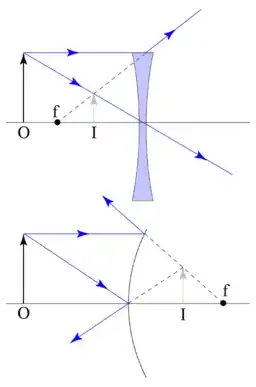

Next examine the situation for virtual images (from http://en.wikipedia.org/wiki/Virtual_image):
virtual images formed by a single concave lens or convex mirror
Notice here that the image is formed by a one or more dashed lines (possibly with some solid lines). The dashed lines are draw off the back of solid lines and represent the apparent path of light rays from the image to the optical surface, but no light from the object ever moves along those paths. This light energy from the object is dispersed, not collected and can not be projected onto a screen. There is still a "image" there, because those dispersed rays all appear to be coming from the image. Thus, a suitable detector (like your eye) can "see" the image, but it can not be projected onto a screen.
