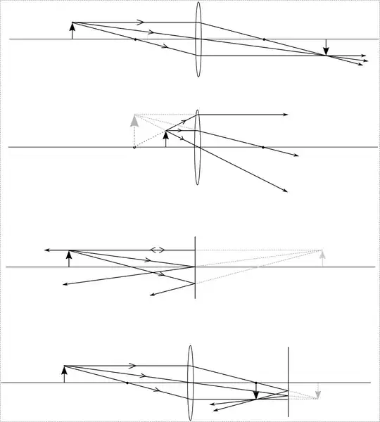

As you mentioned, a plane mirror will produce a virtual image of a real object. But indeed, it is correct that a plane mirror will also produce a real image of a virtual object. This can occur when you have more than one optical element in the optical system. Then the object of one component becomes the image of the next optical component.
So let's give an example of a real and virtual images. And how, by combining a lens and a mirror we can get a virtual (intermediate) object. We'll use the standard convention (see https://apps.spokane.edu/InternetContent/AutoWebs/AsaB/Phys103/MirrorsThinLens.pdf).
Caption goes here
On the top, we have an object to the left of the focal point in a converging lens. This forms a real image. In this example, we have $d_{o}=+2f$, if we solve the lens equation we get that $d_{i}=+2f$. Since the image distance is positive, it is real.
The upper middle image shows how we can form an imaginary image by moving the object closer to the lens than the focal length. In this particular example, $d_{o}=+f/2$. Solving the lens equation gives us $d_{i}=-f$. We have a virtual image at a distance of $f$ to the left of the lens. Note that the dashed gray lines aren't actual rays of light, but are backward extensions. If we were to put a screen where the virtual image was, we wouldn't see an image on the screen.
The lower middle image shows us how a mirror takes real object and generates virtual image.
Finally, on the bottom image, we see a two component system composed of 1) converging lens and 2) a mirror. The mirror is a distance of $3f/2$ to the right of the lens. The first component, the lens, acts the same way as on the top figure with $d_{o1}=+2f$ and $d_{i1}=+2f$. Now the image of the lens acts as the object for the mirror, but note that this image/object lies behind mirror. It is therefore a virtual object. The object distance is $d_{o2}=3f/2-2f=-f/2$. The image distance therefore is $d_{i2}=+f/2$ to the left of the mirror. It is a real image.

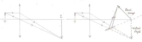

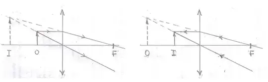

Consider the image formed by a magnifying glass and then reverse the direction in which the light travels.
To analyse the right hand arrangement it is convenient to define a "virtual object" which would have been formed at position $O$ in the right hand diagram but was not allowed to by the interceding lens.
When using the lens equation etc the convention used will have something about real and virtual images and real objects, well to analyse this situation one would have to decide what to do with a virtual object.
With your plane mirror it is easy to show that it can produce a real image.
In fact with the mirror that small the real image formed by the lens would also be seen where I have put the label virtual object.
