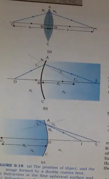

Here’s an image from my textbook
  • enter image description here
It shows, how an image is obtained from a convex lens. The second and the third images, shows in depth , that how a convex lens behaves.
They say, that suppose ( in figure 2 ) the light ray enters the lens from the interface N1 B C. This forms a virtual image I1. Now this virtual image acts like an object for the second interface, and thus forms a real image at I ( figure 3 ) .
What is this virtual object? How can rays come from this virtual object towards the lens, from the right , and again the image is formed at the right hand side. This is possible only in concave lenses and in convex lenses when the object is between P and F. But neither of the cases apply here. What is it actually?
WHY do we treat this as an ‘object’ even when it does not exist?
PS- I know we do this with plane mirrors and others too, but thats reasonable there but here, the object and the image are on the same side! So whats it?

The virtual image for Interface 2 here actually means, that the image would have been there if the second interface did not alter the path of light. But due to interface 2, the position of (would have been image, l1) is changed to l. It is "would have been" image, not a virtual object. The virtual object for interface 2 is where the light seems to be coming from, means in exactly opposite direction of l1 along the ray of light. Because, it is a "would have been image", and virtual object is directly opposite, the virtual object and final image are not on the same side.

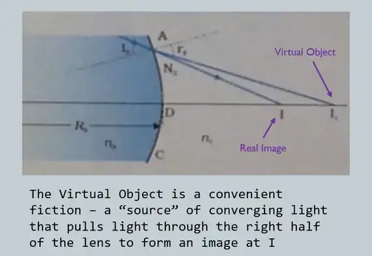

A virtual object is a convenient fiction that you'd introduce when you need a source of converging light that would allow you to analyze part of your system in isolation. You can think of it as a light attractor.
Generally when analyzing a system, you'll use the term "object" when you need a source of rays/photons as the "input" to your analysis.
A "real object" is simple. It creates or scatters light from a location where something actually is. So it is a source of diverging light.
But sometimes, say when you're analyzing just the right lens surface in your figure in isolation, what you really want to set up the problem conveniently is a source of converging light. Basically a light attractor that creates the conditions to where light is converging to a location.
Such a thing doesn't exist, but like with a virtual image, where an optical system such as a mirror is required to make it appear as if light is diverging from a point that no photons ever pass through, with an optical system, you can set up conditions so that light is converging to a point. That is what the left side of the lens does in your figure. Rather than consider the full system, you can analyze just the right side by introducing a virtual object as a source of converging light.

We know that if the ray was allowed to move straight after the first refraction, an image at I1 will have been formed But it suffers another refraction and image i is formed.
Now, what will happen if we place an object at I? Light retraces its path so it will emerge anti parallel to that of the path towards i1 Thus a virtual image will be formed at i1 So if an object is placed at i, an image is formed at i1 Since the refraction formulae for curved surfaces does not change anyhow if u&vare replaced (N1/u__N2/v=N1_N2÷R) as it is symmetric therefore We can equally say that if object is assumed at I1 image at I will be formed
