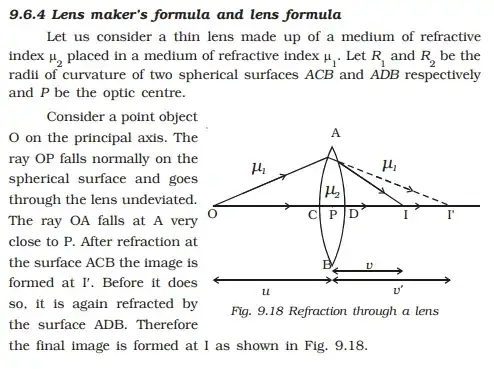

But my textbook is contradictory. According to my textbook, the virtual object and the image are on the same side. The following are screenshots from my textbook: enter image description here
So, which one is correct ?

In contrast, the term "virtual object" both from your textbook and the link you provided describe an intermediate object that WOULD BE the image IF only one refraction occured.
So possibly you, the link and the textbook are all right because you talk about different things (virtual image vs. virtual object). Anyway, in no case "the direction where the light comes from" plays a role in the explanation.
