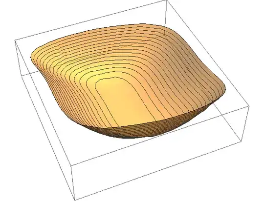

This needs to be fiddled with a bit to get working - I ended up using $H=p^2-px+x^6$ - and as a function of $p$ and $x$, this Hamiltonian looks like the sort of asymmetric bowl we're trying to create:
Mathematica graphics

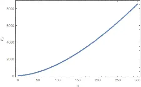

The spectrum looks something like this

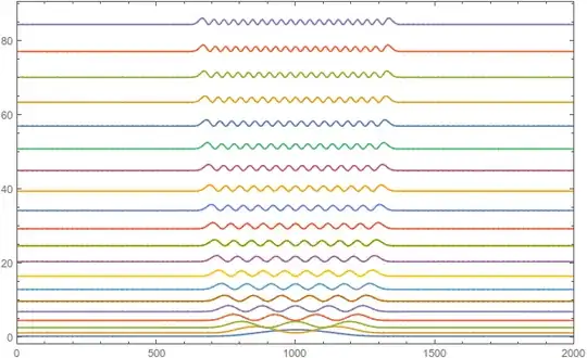

with eigenfunctions looking like this for the first 20,

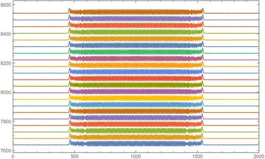

and like this for eigenfunctions 280-300,

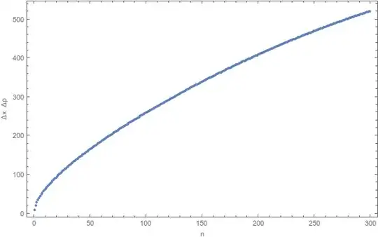

(which is beginning to look a bit raggedy but still has pretty well-resolved oscillations). This leads us, then, to the uncertainty product $\Delta x\,\Delta p$, calculated as
Table[
 Chop[Sqrt[v\[Conjugate].X.X.v] Sqrt[v\[Conjugate].P.P.v]]
 , {v, vecs[[1 ;; 300]]}
which looks like this:
And this, finally, does not seem to have a linear behaviour. There's more to investigate, for sure, but the overall answer seems to be negative.
