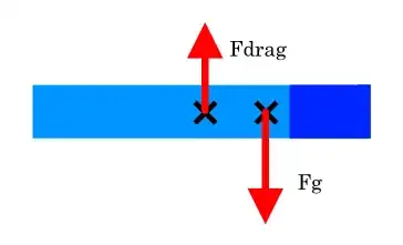

The same reason objects which are heavier on one side tend to fall with the heavy side down: the tip of the arrow is denser than the rest of the arrow. The center of gravity is offset from its geometrical center, so the air drag, which is based on the object's geometry, causes a torque together with gravity as seen in this very professional picture of a body falling straight down. torque

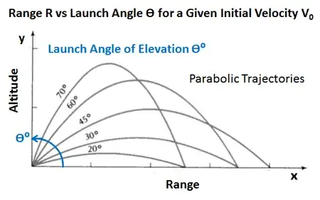

Consider a cannon ball on a windless day. Like any ballistic object it travels in a parabola (or nearly one, considering air resistance). Throughout its trajectory, doesn't the direction of the air flow it experiences change in line with its trajectory?
This graph could be seen as both the path of a projectile and as a vector field for the air flow (or relative wind) force experienced by that projectile at different points along its journey.

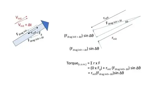

To follow up from the excellent answers of @AccidentalTaylorExpansion and others, I've constructed a diagram showing the weather vane effect of the drag force vector acting on a diagonally shot arrow or javelin at t = 0 and t = 0 + delta t. The two forces acting on the arrow are gravity and air drag. The effect of gravity on the velocity of the center of mass is to move the c.o.m. in a parabolic trajectory. The drag force always opposes the motion of the arrow, and acts on the geometric center of the arrow, at a distance r from the c.o.m.
Because the orientation of the c.o.m. velocity vector changes (rotating clockwise in my diagram), the direction of the drag force on the arrow also changes (also rotating clockwise). This leads to a weather-vane effect on the arrow/javelin, creating a negative torque about the center of mass (directed into page) and a clockwise instantaneous acceleration. enter image description here
