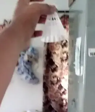

If a shuttlecock is dropped(not giving it any angular momentum wrt it's COM) head up(i.e. the heavier part up) without tilting it, it always falls head down(i.e. the heavier part down). This fact it's not consistent with conservation of angular momentum. Why is this so? Drop it this way

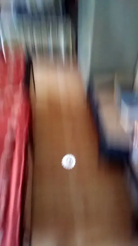

Ends up this way
