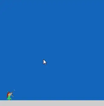

I'm making custom game engine, with custom physics simulation. I ran into a problem while trying to simulate arrows. Here is what I got for now:
First_Prot

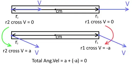

So far, I thought up only some rough clues. On the image below, you can see my idea.
Idea
I assumed that 2 points farthest from the center of body's mass might cause the rotation. When long body is moving straight, there is no rotation induced. But when gravity shifts velocity down, it creates angular velocity, although if body is ideally symmetrical this 2 velocities will cancel out. But if center of mass will be shifted backwards or forwards, angular velocities will not be equal, and object will rotate. I used kind of inverse of angular velocity to linear velocity formula, maybe this is not correct...
As far as I see, there should be no torque induced by gravity, it should be canceled out by torque from opposite side of body.

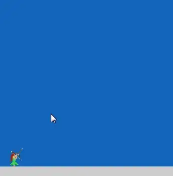

Anyway, I tried to use this approach and (surprisingly) it shows some close results, although not quite as expected...
Idea
