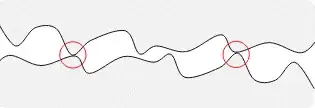

You need to start by considering the microscopic origin of the frictional force.
In most circumstances surfaces are rough so when to touch two surfaces together they actually only make contact at the highest points on the surfaces. We call these high points asperities, and in the diagram below I've outlined in red where the asperities on the surfaces are touching.
Microscopic friction
The consequence of this is that the real area of contact is much smaller than the total area of the overlapping region. Let's call this real area of contact $A_r$.
