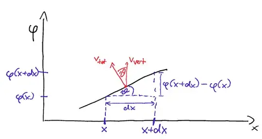

A fake derivation
We can rather easily compute a horizontal velocity for the string fi we assume that the total velocity vector is everywhere normal to the string (this assumption is not always valid, see below). The following picture then illustrates the computation:
Take two infinitesimally separated points $x$ and $x+\mathrm{d}x$ and let the wave motion be $\varphi(x,t)$. The vertical/transverse velocity is $v_\text{vert} = \partial_t \varphi(x,t)$, and the horizontal component is $v_\text{hor} = -v_\text{vert}\tan(\vartheta)$, where $\vartheta$ is the angle between the normal and the vertical, and the minus sign is because if we measure $\vartheta$ in the usual counterclockwise direction then the horizonal velocity points to $-x$ for small $\vartheta$. Now $\tan(\vartheta)$ is $\frac{\varphi(x+\mathrm{d}x) - \varphi(x)}{\mathrm{d}x} = \partial_x\varphi(x)$ , so we get $$ v_\text{hor} = -\partial_t\varphi\partial_x\varphi$$ and if you plug in the sinusoidal solution and take the time average you get exactly the same result as for longitudinal waves. However, you might protext - the transverse wave equation was derived assuming no longitudinal motion, and this computation just blatantly assumes something different.
A Lagrangian derivation

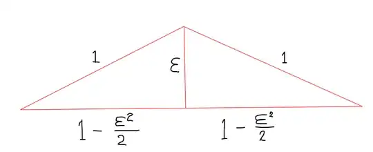

IV) Our starting point is the simple observation that for an unstretchable string $Y \gg \tau $, a small transversal displacement
$$\eta~=~{\cal O}(\varepsilon),\tag{4}$$
where $\varepsilon \ll 1$, must be accompanied with a longitudinal displacement
$$\xi~=~{\cal O}(\varepsilon^2),\tag{5}$$
cf. Fig. 1 below.
$\uparrow$ Fig. 1. An infinitesimal transversal sawtooth displacement $\varepsilon\ll 1$ of an unstretchable string must be accompanied with a longitudinal displacement $\frac{\varepsilon^2}{2}$.
V) We conclude that a realistic model for transversal excitations $\eta$ must include the possibility for longitudinal displacements $\xi$ as well. Let us therefore consider the Lagrangian density
